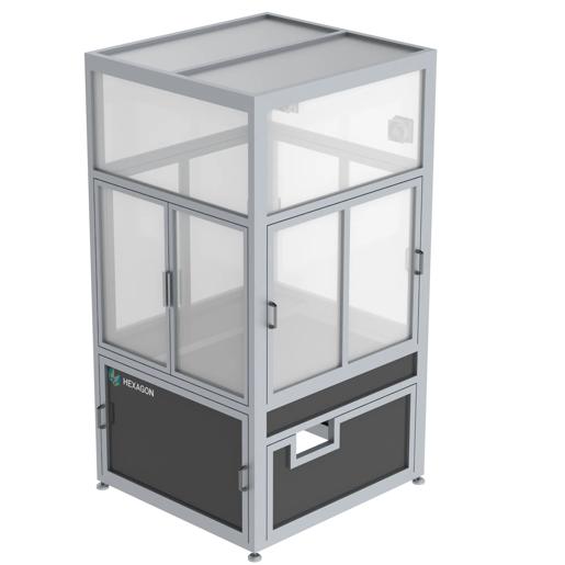

TIGO SF enclosure with filter fans and manual doors as a cost-effective solution for CMM measurements at the production site. Dimensions: 1300 mm x 1400 mm x 2595 mm
Hexagon TIGO SF enclosure as cost-effective solution for measurements in the production environment. It helps protect the valuable CMM from the most extreme workshop conditions.
Features
  • Enclosure dimensions: 1300 mm x 1400 mm x 2595 mm
  • Transparent construction allows all-around visibility
  • Filter fans provide positive air pressure and ensures an effective shelter from dust and dirt
  • Manual doors facilitate the user accessibility to the CMM
  • Removeable panels with turnkey locks
  • Internal LED light strips which do not affect the thermal measuring condition
  • Integrated shelf for Jog Box and other accessories
  • Mains power strip under the shelf
  • Rotary Isolator for mains power
  • Delivered in a flat-pack version for self-assembly
  • Its simple design makes it extremely easy and fast to mount and set-up
