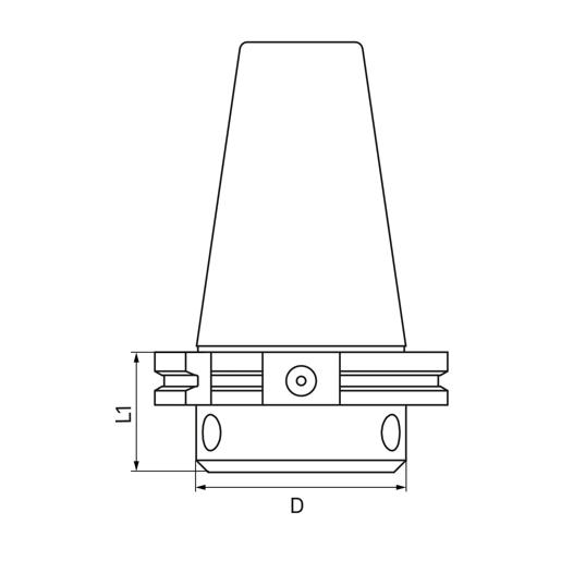

Taper shank DIN ISO 7388 SK50 for use with Hexagon touch probes with D28 connection. With contact surface in higher surface quality and dimensional accuracy. For probe activation via preloaded Hexagon pull stud or bidirectional activation in the machine tool.
Hexagon original accessories for measuring systems in the machine tool ensure maximum precision and reliability in production. The shank establishes a secure connection between the touch probe and the spindle in the machine tool. Hexagon offers a wide range of shanks for various interfaces and different probe activation methods.

Onderdeelnummer D28-SK50P-A/B
Product Type Taper Shank (SK)
Interface D28
Activeringsmethode Pull Stud Activation (A)
Bidirectioneel (B)
Standaard werktuigopname DIN ISO 7388-1
Pull Stud Compatibility AZ-03
AZ-03+25MM
AZ-05/19
AZ-13
AZ-14
AZ-15
Diameter (D) 69,85 mm
Lengte (L1) 40 mm
Materiaal Roestvast staal
Touch Probe Compatibility IRP25.10
IRP25.41
IRP25.44
IRP25.50
RWP20.10
RWP20.41
RWP20.44
RWP20.50-G
RWP20.50-M
LS-R-4.8
