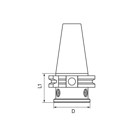

Taper shank SK40/CAT40 with metric pull stud thread for use with Hexagon touch probes with D28 connection. For probe activation in machine tools with programmable through-spindle coolant or switchable air blast > 3.5 bar.

Onderdeelnummer D28-SK/CAT40-W
Product Type Taper Shank (SK)
Interface D28
Activeringsmethode Water-switch (W)
Standaard werktuigopname DIN ISO 7388-1 / ASME B5.50
Diameter (D) 50 mm
Lengte (L1) 40 mm
Materiaal Roestvast staal
