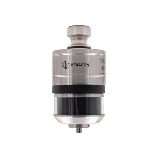

Modular radio-wave touch probe for flexible measurement tasks.
The m&h RWP20.50-G-PP is a modular radio-wave touch probe operating in the 2.4 GHz frequency range. It offers bidirectional communication and can be customized with various measuring units, extensions, and cross-probes. This flexibility allows for optimal adaptation to future requirements and diverse applications within the machine tool.
Onderdeelnummer 20.50-RWP-G-PP#
Probe Type Radio-wave Probe
Transmission Frequency 2400 - 2483,5 MHz (2,4 GHz)
Transmission/Reception Range Up to 18 m
Tast richting ±X; ±Y; -Z
Stylus montage M4
Max. Stylus Overtravel XY = ±12,5°
Z = -6 mm
Recommended Probing Feedrate Max. 2000 mm/min
Stroomvoorziening 1x 9 V Battery, Block, 6LR61
Lithium: 1200 mAh, Alkaline: 550 mAh
Max. levensduur batterij Lithium Battery: Operation 500 h, Standby 1 Year
Materiaal Stainless Steel / POM
Temperatuurbereik Werking: 10 °C - 50 °C
Opslag: 5°C - 70°C
Unidirectional Repeatability max. 1 µm (2 Sigma)
met 50 mm stylus en 254 mm/min tastvoeding
Beschermingsklasse IP68: EN60529
Weight (without Tool Holder) ca. 940 g
