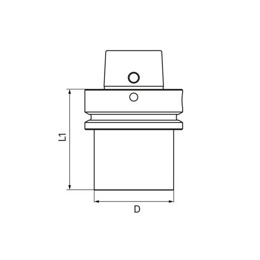

Hollow taper shank HSK63 Form F for use with Hexagon touch probes with D28 connection and bidirectional activation in the machine tool.
Hexagon original accessories for measuring systems in the machine tool ensure maximum precision and reliability in production. The shank establishes a secure connection between the touch probe and the spindle in the machine tool. Hexagon offers a wide range of shanks for various interfaces and different probe activation methods.
Interface
  • D28
Shank Activation Method
  • Bidirectional: The touch probe is activated via a signal sent from the receiver.
  • Bidirectional: IRP25.50, RWP20.50-G, RWP20.50-M, LS-R-4.8
Extended probe configurations are possible by using suitable adapters
Probe Compatibility with Modular Adapter D20-MO-B and probe activation
  • Bidirectional: IRP40.01, IRP40.02, IRP40.40-LF, IRP40.42, TP-R-400
Probe Compatibility with Modular Adapter D20-MO-B-D50 and probe activation
  • Bidirectional: RWP38.41
Probe Compatibility with Modular Adapter 5942 and probe activation
  • Bidirectional: IRP60.00
Onderdeelnummer D28-HSK63F-B
Product Type Hollow Taper Shank (HSK)
Interface D28
Activeringsmethode Bidirectioneel (B)
Standaard werktuigopname DIN 69893-6
Vorm
Diameter (D) 51 mm
Lengte (L1) 65 mm
Materiaal Roestvast staal
Touch Probe Compatibility IRP25.50
RWP20.50-G
RWP20.50-M
LS-R-4.8
