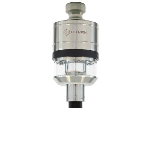

Modular infrared touch probe IRP25.50 with measuring unit TP44.10 for measuring the workpiece temperature before or during the machining process.
The m&h IRP25.50 is a bidirectional infrared touch probe characterized by its modular structure. It supports various measuring units, extensions, and cross-probes, enabling optimal adjustment to future requirements and applications in the machine tool. The system is designed for flexibility and future-proofing measurement tasks.

1x Infrared Touch Probe IRP25.50-TP
1x Storage Box
