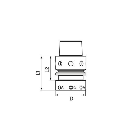

Thermal insulated hollow taper shank HSK32 Form E for use with Hexagon touch probes with D20 connection and bidirectional activation in the machine tool.
Toegevoegd aan winkelwagen.
Hexagon original accessories for measuring systems in the machine tool ensure maximum precision and reliability in production. The shank establishes a secure connection between the touch probe and the spindle in the machine tool. Hexagon offers a wide range of shanks for various interfaces and different probe activation methods.
Interface
- D20
Shank Activation Method
- Bidirectional: The touch probe is directly activated via a signal sent from the receiver.
Thermal Insulation
- Shanks with thermal insulation prevent the transfer of heat from the spindle to the probe. These shanks are used in particular on HSC machines.
- Bidirectional: IRP40.01, IRP40.02, IRP40.40-LF, IRP40.42, RWP38.41, TP-R-400
| Onderdeelnummer | D20-HSK32E-TI-B |
| Product Type | Hollow Taper Shank (HSK) |
| Interface | D20 |
| Activeringsmethode | Bidirectioneel (B) |
| Standaard werktuigopname | DIN 69893-5 |
| Vorm | E |
| Shank Thermal Insulated | Ja |
| Diameter (D) | 32 mm |
| Lengte (L1) | 36 mm |
| Lengte (L2) | 25,5 mm |
| Materiaal | Roestvast staal |
| Touch Probe Compatibility |
IRP40.01 IRP40.02 IRP40.40 IRP40.42 RWP38.41 TP-R-400 |
