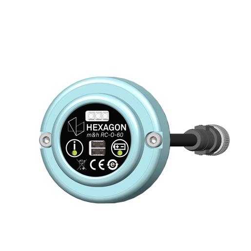

Robust stainless steel optical receiver for the m&h Touch Probe with optical transmission TP-O-400, providing reliable signal transmission, touch probe activation/deactivation, and communication with the machine controller. Cable outlet: axial
The m&h Infrared Receiver RC-O-60-A with axial cable outlet is designed for use with the m&h TP-O-400 optical touch probe system. It receives measurement signals from the touch probe, controls probe activation and deactivation, and ensures reliable communication with the machine controller.
Application
  • The RC-O-60-A provides reliable signal transmission and seamless communication between the TP-O-400 touch probe and the machine controller, helping to ensure stable and dependable measurement processes.
Features
  • Wide transmission and reception angles
  • Innovative and secure HxPCM (Hexagon Pulse Code Modulation) technology processes only system-specific signals, minimizing interference from ambient light.
  • Easy and flexible installation directly on the machine wall
  • Cable outlet axial
  • Robust stainless steel housing
  • Optical status indicators
  • Waterproof sealing according to IP68
Delivery Contents
1x m&h Receiver with optical transmision RC-O-60-A with axial cable outlet (factory setting)
1x Connecting cable (L = 0.2 m / 0.65') and M12 plug
Mounting material
All images are for illustrative purposes only and may differ from the actual product.
Onderdeelnummer RC-O-60-A#
Ontvangertype Infraroodontvanger
Afmetingen van de ontvanger Ø59,5 mm x 26,1 mm (Ø2,36″ x 1,02")
Signaalevaluatie HxPCM (Hexagon Pulse Code Modulation)
Stroomvoorziening 12 - 30 VDC, max. 100 mA
Temperatuurbereik Werking: 5 °C - 55 °C
Opslag: -25°C - 70°C
Materiaal Roestvast staal
Beschermingsklasse IP68: EN60529
Verbindingskabel 0,2 m, met stekker
Bevestiging 2x Cilinderkopschroef M4x22
Taster compatibiliteit TP-O-400
Gewicht ca. 360 g (met kabel)
