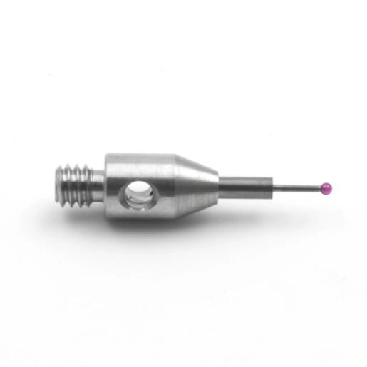

Straight stylus with M2 thread, ruby ball Ø0.3 mm, tungsten carbide stem (stepped) Ø0.2 mm / 1 mm, length 9.85 mm. For use on machine tools. Previous part number: 91.00-T10/0.3-HM-M2
The stylus is an important part of the measuring system. During the measurement, the stylus is in direct contact with the part. Straight styli are the most common type used in the metrology industry. Depending on the application, different connections, materials for stems and tips are available.
Ruby is the most widely-used material for stylus tips. Thanks to its inexpensive price and high quality, it is the standard choice for most applications. It is an extremely hard material.
A tungsten carbide stem has high stiffness and less thermal expansion, compared to stainless steel.
| Onderdeelnummer | H00027462 |
| Schroefdraad | M2 |
| Meetapparaat | Bewerkingsmachine |
| Kogel materiaal | Robijn |
| Kogel diameter (D) | 0,3 mm |
| Oud artikelnummer: | 91.00-T10/0.3-HM-M2 |
| Lengte (L) | 9,85 mm |
| Schacht materiaal | Wolfraamcarbide |
| Schacht diameter (S) | 0.2 / 1 mm |
| Gewicht | 4,6 g |
