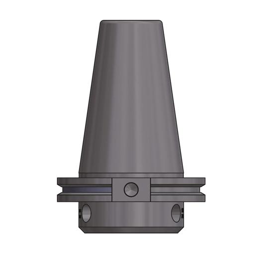

Taper shank SK50 for use with Hexagon touch probes with D28 connection. For probe activation via preloaded Hexagon pull stud or bidirectional activation in the machine tool.
Hexagon original accessories for measuring systems in the machine tool ensure maximum precision and reliability in production. The shank establishes a secure connection between the touch probe and the spindle in the machine tool. Hexagon offers a wide range of shanks for various interfaces and different probe activation methods.
Interface
- D28
Shank Activation Method
- Bidirectional: The touch probe is activated via a signal sent from the receiver.
- Pull stud activation: The touch probe is activated with a shank equipped with a hexagon pull stud by pulling on the pull stud.

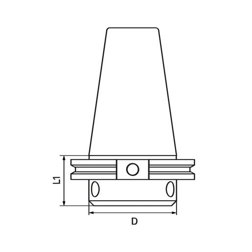

| Onderdeelnummer | D28-SK50-A/B |
| Product Type | Taper Shank (SK) |
| Interface | D28 |
| Activeringsmethode |
Pull Stud Activation (A) Bidirectioneel (B) |
| Standaard werktuigopname | DIN ISO 7388-1 |
| Pull Stud Compatibility |
AZ-03 AZ-03+25MM AZ-05/19 AZ-13 AZ-14 AZ-15 |
| Diameter (D) | 69,85 mm |
| Lengte (L1) | 40 mm |
| Materiaal | Roestvast staal |
| Touch Probe Compatibility |
IRP25.10 IRP25.41 IRP25.44 IRP25.50 RWP20.10 RWP20.41 RWP20.44 RWP20.50-G RWP20.50-M LS-R-4.8 |
