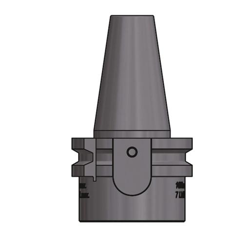

Taper shank DIN ISO 7388 SK30 for use with Hexagon touch probes with D28 connection. For probe activation in machine tools with programmable through-spindle coolant or switchable air blast > 3.5 bar.
Hexagon original accessories for measuring systems in the machine tool ensure maximum precision and reliability in production. The shank establishes a secure connection between the touch probe and the spindle in the machine tool. Hexagon offers a wide range of shanks for various interfaces and different probe activation methods.

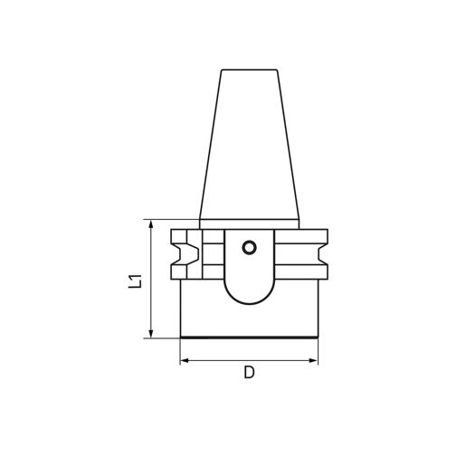

| Onderdeelnummer | D28-SK30-W |
| Product Type | Taper Shank (SK) |
| Interface | D28 |
| Activeringsmethode | Water-switch (W) |
| Standaard werktuigopname | DIN ISO 7388-1 |
| Diameter (D) | 44 mm |
| Lengte (L1) | 38 mm |
| Materiaal | Roestvast staal |
