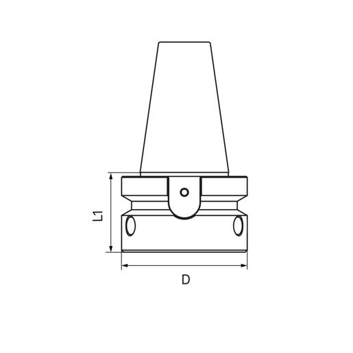

Taper shank JIS BT40 for use with Hexagon touch probes with D28 connection. For probe activation in machine tools with programmable through-spindle coolant or switchable air blast > 3.5 bar.
Hexagon original accessories for measuring systems in the machine tool ensure maximum precision and reliability in production. The shank establishes a secure connection between the touch probe and the spindle in the machine tool. Hexagon offers a wide range of shanks for various interfaces and different probe activation methods.
Interface
  • D28
Shank Activation Method
  • Water-switch: This mechanical activation method can be applied to all machines with programmable through-spindle coolant or switchable air blast > 3.5 bar. The touch probe is activated by programmed switching on of the medium by the M code. The probe is active while under pressure.
  • Mechanical: IRP25.10, IRP25.41, IRP25.44, IRP25.50, RWP20.10, RWP20.41, RWP20.44, RWP20.50-G, RWP20.50-M
  • Bidirectional: IRP25.50, RWP20.50-G, RWP20.50-M, LS-R-4.8
Extended probe configurations are possible by using suitable adapters.
Probe Compatibility with Modular Adapter D20-MO-B and probe activation
  • Bidirectional: IRP40.01, IRP40.02, IRP40.40-LF, IRP40.42, TP-R-400
Probe Compatibility with Modular Adapter D20-MO-B-D50 and probe activation
  • Bidirectional: RWP38.41
Probe Compatibility with Modular Adapter D20-MO-A/W/M/P and probe activation
  • Mechanical: IRP32.00, RWP38.10
Probe Compatibility with Modular Adapter 5942 and probe activation
  • Bidirectional: IRP60.00
Onderdeelnummer D28-BT40-W
Product Type Taper Shank (SK)
Interface D28
Activeringsmethode Water-switch (W)
Standaard werktuigopname ISO 7388-2 (JIS B 6339)
Diameter (D) 63 mm
Lengte (L1) 40 mm
Materiaal Roestvast staal
Touch Probe Compatibility IRP25.10
IRP25.41
IRP25.44
IRP25.50
RWP20.10
RWP20.41
RWP20.44
RWP20.50-G
RWP20.50-M
LS-R-4.8
