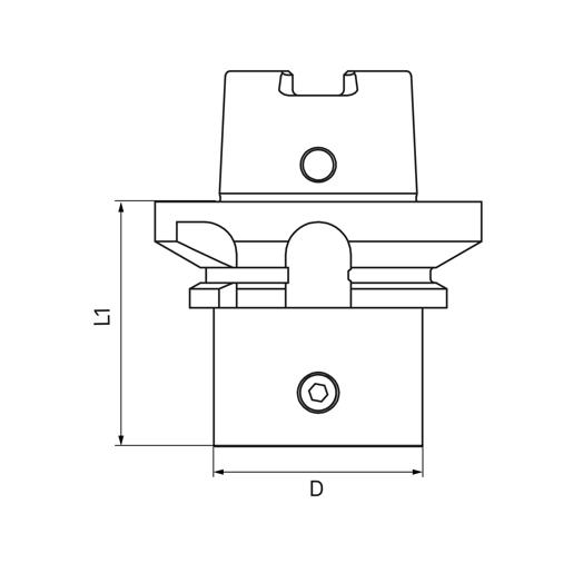

Hollow taper shank HSK63 Form A for use with Hexagon touch probes with D28 connection. For probe activation in machine tools with programmable through-spindle coolant or switchable air blast > 3.5 bar.

Onderdeelnummer D28-HSK63-80A-W
Product Type Hollow Taper Shank (HSK)
Interface D28
Activeringsmethode Water-switch (W)
Standaard werktuigopname DIN 69893-HSK-A63 (Shank and gripper grooves)
DIN 69893-HSK-A80 (Contact surface diameter)
Vorm
Diameter (D) 51 mm
Lengte (L1) 60 mm
Materiaal Roestvast staal
