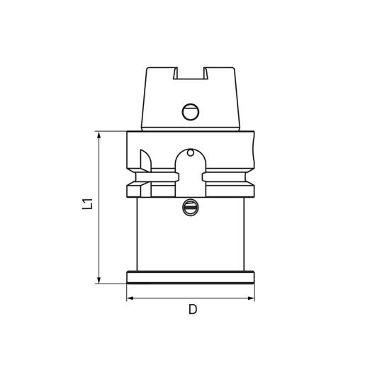

Hollow taper shank HSK50 Form A for use with Hexagon touch probes with D28 connection and mechanical activation in the machine tool.
Hexagon original accessories for measuring systems in the machine tool ensure maximum precision and reliability in production. The shank establishes a secure connection between the touch probe and the spindle in the machine tool. Hexagon offers a wide range of shanks for various interfaces and different probe activation methods.

Onderdeelnummer D28-HSK50A-M
Product Type Hollow Taper Shank (HSK)
Interface D28
Activeringsmethode Mechanisch (M)
Standaard werktuigopname DIN 69893-1
Vorm
Diameter (D) 50 mm
Lengte (L1) 60 mm
Materiaal Roestvast staal
