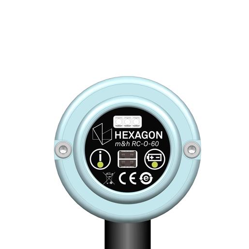

Robust stainless steel optical receiver for the m&h Touch Probe with optical transmission TP-O-400, providing reliable signal transmission, touch probe activation/deactivation, and communication with the machine controller. Cable outlet: radial
The m&h Infrared Receiver RC-O-60-R with radial cable outlet is designed for use with the m&h TP-O-400 optical touch probe system. It receives measurement signals from the touch probe, controls probe activation and deactivation, and ensures reliable communication with the machine controller.
Application
  • The RC-O-60-R provides reliable signal transmission and seamless communication between the TP-O-400 touch probe and the machine controller, helping to ensure stable and dependable measurement processes.
Features
  • Wide transmission and reception angles
  • Innovative and secure HxPCM (Hexagon Pulse Code Modulation) technology processes only system-specific signals, minimizing interference from ambient light.
  • Easy and flexible installation directly on the machine wall
  • Robust stainless steel housing
  • Cable outlet radial
  • Optical status indicators
  • Waterproof sealing according to IP68
Delivery Contents
1x m&h Receiver with optical transmision RC-O-60-R with radial cable outlet (factory setting)
1x Connecting cable (L = 2 m / 6.56'), with protection tube (1.5 m / 4.92') and M12 plug
Mounting material
All images are for illustrative purposes only and may differ from the actual product.
Referencia RC-O-60-R#
Tipo de receptor Receptor infrarrojo
Dimensiones del receptor Ø59,5 mm x 26,1 mm (Ø2,36″ x 1,02")
Evaluación de la señal HxPCM (Hexagon Pulse Code Modulation)
Alimentación 10 - 32 VCC, máx. 100 mA
Rango de temperatura Manejo: 5°C - 55 °C
Almacenamiento: -25°C - 70°C
Material Acero inoxidable
Clase de protección IP68: EN60529
Cable de conexión 2 m con conector
Tubo de protección 1,5 m (PUR)
Montaje 2x Tornillo cilíndrico M4x22
Compatibilidad de sensores TP-O-400
Peso aprox. 585 g (con cable y tubo de protección)
