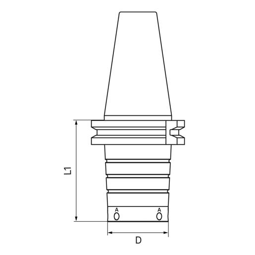

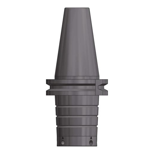

Taper shank DIN ISO 7388 SK40 for use with Hexagon touch probes with D20 connection and bidirectional probe activation in the machine tool. Shank Length: 70 mm / 2.75"
Hexagon original accessories for measuring systems in the machine tool ensure maximum precision and reliability in production. The shank establishes a secure connection between the touch probe and the spindle in the machine tool. Hexagon offers a wide range of shanks for various interfaces and different probe activation methods.

| Referencia | D20-SK40-70-B |
| Tipo de producto | Taper Shank (SK) |
| Interface | D20 |
| Método de activación | Bidireccional (B) |
| Portaherramienta estándar | DIN ISO 7388-1 |
| Diámetro (D) | 40 mm |
| Longitud (L1) | 70 mm |
| Material | Acero inoxidable |
