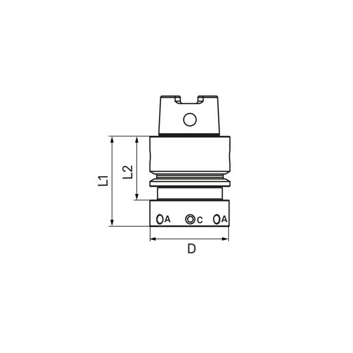

Hollow taper shank HSK32 for use with of Hexagon touch probes with D20 connection and bidirectional activation in the machine tool.
Hexagon original accessories for measuring systems in the machine tool ensure maximum precision and reliability in production. The shank establishes a secure connection between the touch probe and the spindle in the machine tool. Hexagon offers a wide range of shanks for various interfaces and different probe activation methods.

| Referencia | D20-HSK32-B |
| Tipo de producto | Hollow Taper Shank (HSK) |
| Interface | D20 |
| Método de activación | Bidireccional (B) |
| Portaherramienta estándar |
DIN 69893-5 (Shank) DIN 69893-1 (Driver Groove) |
| Diámetro (D) | 32 mm |
| Longitud (L1) | 36 mm |
| Longitud (L2) | 29 mm |
| Material | Acero inoxidable |
| Compatibilidad sonda |
IRP40.01 IRP40.02 IRP40.40 IRP40.42 RWP38.41 TP-R-400 |
