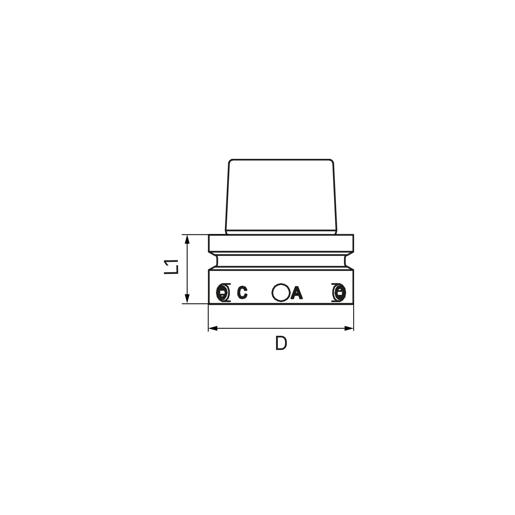

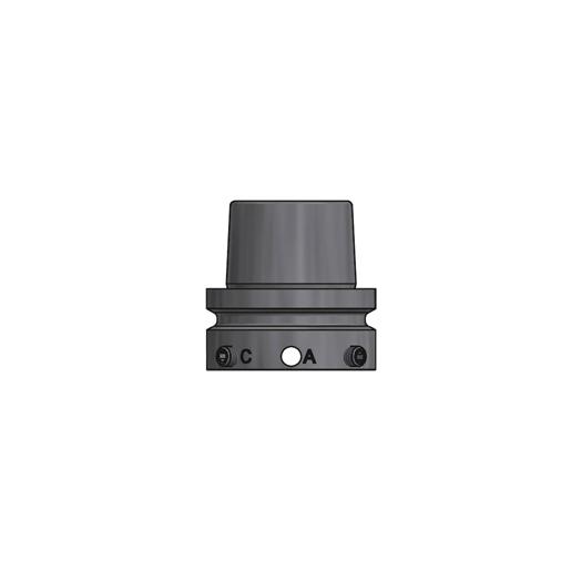

Hollow taper shank HSK25 Form E for use with Hexagon touch probes with D16 connection and bidirectional activation in the machine tool.
Hexagon original accessories for measuring systems in the machine tool ensure maximum precision and reliability in production. The shank establishes a secure connection between the touch probe and the spindle in the machine tool. Hexagon offers a wide range of shanks for various interfaces and different probe activation methods.
Interface
- D16
Shank Activation Method
- Bidirectional: The touch probe is directly activated via a signal sent from the receiver.
- Bidirectional: IRP40.50, IRP40.51
| Referencia | D16-HSK25E-B |
| Tipo de producto | Hollow Taper Shank (HSK) |
| Interface | D16 |
| Método de activación | Bidireccional (B) |
| Portaherramienta estándar | DIN 69893-5 |
| Forma | E |
| Diámetro (D) | 25 mm |
| Longitud (L1) | 12 mm |
| Material | Acero inoxidable |
| Compatibilidad sonda |
IRP40.50 IRP40.51 |
