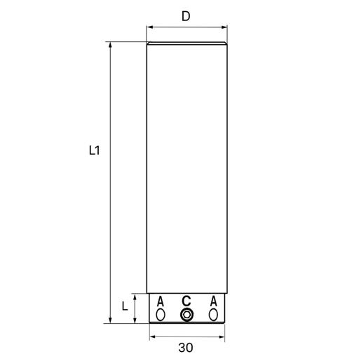

Cylindrical tool holder for use with Hexagon touch probes with D20 connection and bidirectional activation in the machine tool.
Hexagon original accessories for measuring systems in the machine tool ensure maximum precision and reliability in production. The shank establishes a secure connection between the touch probe and the spindle in the machine tool. Hexagon offers a wide range of shanks for various interfaces and different probe activation methods.

| Referencia | D20-D32-L100-B |
| Tipo de producto | Cylindrical Shaft |
| Interface | D20 |
| Método de activación | Bidireccional (B) |
| Diámetro (D) | 32 mm |
| Longitud (L) | 12 mm |
| Longitud (L1) | 112 mm |
| Material | Acero inoxidable |
