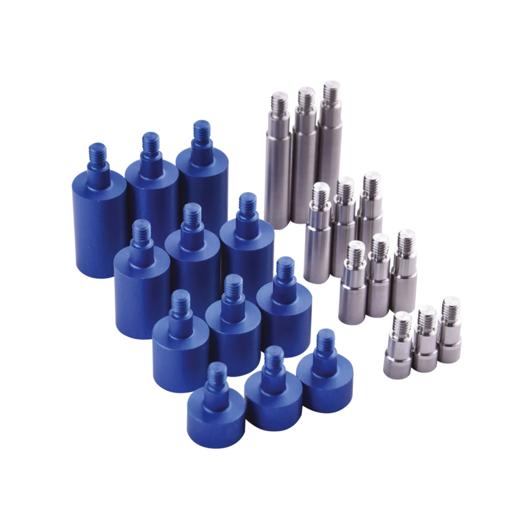

Clamping and stop pin set for 6-jaw chucks (Aluminium / D = Ø160 mm).
Advantages
- Modular system for different components
- Clamping and height stop pins easy to screw in
- Good accessibility with star styli or swivelling measuring heads
Compatibility
- 6-Jaw chuck with flange (FC-160AL6)
- 6-Jaw chuck without flange (FC-160AL6-NF)
Delivey contents
12x Clamping pins (Stainless steel)
9x Stop pins (Aluminium anodised)
delivered on ground plate
| Referencia | FC-PS-160AL6 |
| Diameter Clamping Pins (D1) | 8 mm |
| Diameter Stop Pins (D2) | 15 mm |
| Lengths from Clamping Jaw (A6 - A9) | 7, 12, 17, 22 mm |
| Lengths from Clamping Jaw (S1-S5) | 5, 10, 15, 20, 25 mm |
| Chuck Compatibility |
FC-160AL6 FC-160AL6-NF |
| Peso | 830 g |
