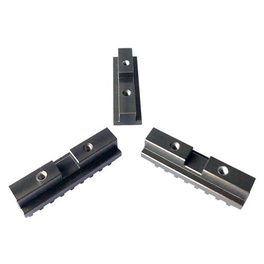

Basic jaw set made of aluminum with hard-coated surface. Compatible with 3-jaw chucks made of aluminium with Ø 240 mm.
Basic jaw set made from aluminum with a durable hard-coated surface. Provides a stable foundation for flexible clamping setups and precise, repeatable positioning. Compatible with Hexagon Ø 240 mm aluminum 3-jaw chucks, with or without flange.
Compatibility
- 3-Jaw chuck with flange (FC-240AL3)
- 3-Jaw chuck without flange (FC-240AL3-NF)
Delivery Contents
1x Basic jaw set (Aluminium)
The image is for illustration purposes only. The actual product may differ from the product shown.

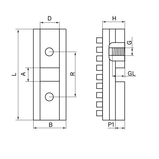

| Referencia | FC-JS-240AL3-I |
| Material | Aluminium with hard coated surface |
| Maximum Height (H) | 19 mm |
| Distancia entre centros (R) | 50 mm |
| Rosca (G) | M6 |
| Longitud de rosca (GL) | 9 mm |
| Longitud (L) | 100 mm |
| Jaw Width | 24,7 mm |
| InterfaceLength (P1) | 4 mm |
| Ridge Width (D) | 14,5 mm |
| Interface (A) | 10 mm |
| Chuck Compatibility |
FC-240AL3 FC-240AL3-NF |
| Peso | 240 g |
