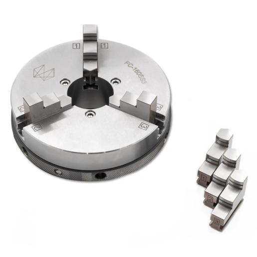

Three-jaw chuck made from stainless steel with an outside diameter of 160 mm. For inside and outside clamping of parts on coordinate measuring machines.
Extremely precise, self-centring and highly repeatable chucks from Hexagon generate a homogenous clamping force and help users to achieve the highest levels of precision and quality in the measurement process.
Delivery Contents
1x Three-jaw chuck
3x Clamping jaws for inside clamping
3x Clamping jaws for outside clamping
1x Clamping wrench
3x Fixing elements M6 screws
Further information can be found in the CAD-file.
Please note:
This chuck is not compatible with the integrated rotary table iRT 4 HD.
| Referencia | FC-160SS3-NF |
| Diámetro exterior mandril (D1) | 160 mm |
| Diámetro orificio central (L) | 46 mm |
| Area de fijación exterior (A) | 1 - 150 mm |
| Area de fijación interior (I) | 34 - 174 mm |
| Material | Acero inoxidable |
| Fijación (G) | M6 |
| Screw Hole Circle (T) | 59 mm |
| Area de fijación exterior (A1) | 1 - 81 mm |
| Area de fijación exterior (A2) | 34 - 114 mm |
| Area de fijación exterior (A3) | 70 - 150 mm |
| Area de fijación interior (I1) | 34 - 114 mm |
| Area de fijación interior (I2) | 94 - 174 mm |
| Altura de las mordazas (H2) | 23,75 mm |
| Altura del paso (S) | 10 mm |
| Altura hasta las mordazas (H1) | 40,5 mm |
| Thread Length (GL) | 9 mm |
| Peso | 6.570 g |
