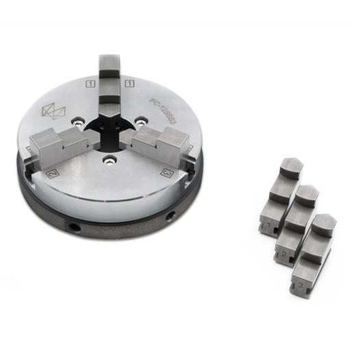

3-Jaw Chuck without Flange (Stainless Steel / D=125 mm)
ID:
FC-125SS3-NF
1.300,00 €
Precio neto sin envio
Tiempo de entrega 10-15 días
Descripción rápida
3-jaw chuck made from stainless steel with an outside diameter of 125 mm. For inside and outside clamping of parts on coordinate measuring machines.
Extremely precise, self-centring and highly repeatable chucks from Hexagon generate a homogenous clamping force and help users to achieve the highest levels of precision and quality in the measurement process.
Further information
Delivery contents
- 1x 3-Jaw Chuck without Flange (Stainless Steel / D=125 mm)
- 3x Clamping jaws (3 pieces) for inside clamping
- 3x Clamping jaws (3 pieces) for outside clamping
- 1x Clamping wrench
- 3x M5 screws
Please note
- This chuck is not compatible with the integrated rotary table iRT 4 HD.
| Referencia | FC-125SS3-NF |
| Diámetro exterior mandril (D1) | 125 mm |
| Diámetro orificio central (L) | 36 mm |
| Area de fijación exterior (A) | 1 - 126 mm |
| Area de fijación interior (I) | 32 - 122 mm |
| Material | Acero inoxidable |
| Fijación (G) | M5 |
| Screw Hole Circle (T) | 50 mm |
| Area de fijación exterior (A1) | 1 - 61 mm |
| Area de fijación exterior (A2) | 30 - 90 mm |
| Area de fijación exterior (A3) | 66 - 126 mm |
| Area de fijación interior (I1) | 32 - 92 mm |
| Area de fijación interior (I2) | 62 - 122 mm |
| Altura de las mordazas (H2) | 19,5 mm |
| Altura del paso (S) | 7,5 mm |
| Altura hasta las mordazas (H1) | 36 mm |
| Thread Length (GL) | 7,5 mm |
| Peso | 3.780 g |
