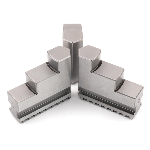

3-Jaw clamping set for inside clamping. Made of stainless steel, vacuum hardened and polished. Compatible with stainless steel 3-jaw chucks, Ø70 mm.
3-Jaw Clamping Set
- For inside clamping
- Made of stainless steel, vacuum-hardened, ground
Compatibility
- 3-Jaw chuck with flange (FC-70SS3)
- 3-Jaw chuck without flange (FC-70SS3-NF)
Delivery contents
1x 3-Jaw clamping set

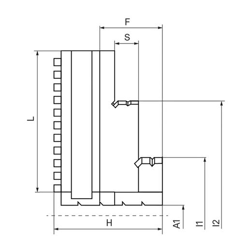

| Referencia | FC-JS-70SS3-I |
| Material | Stainless Steel, vacuum-hardened, ground |
| Area de fijación exterior (A1) | 1 - 26 mm |
| Area de fijación interior (I1) | 18 - 43 mm |
| Area de fijación interior (I2) | 41 - 66 mm |
| Altura del paso (S) | 6,5 mm |
| Height from Chuck Body (F) | 17 mm |
| Maximum Height (H) | 28 mm |
| Longitud (L) | 31 mm |
| Jaw Width | 11,7 mm |
| Chuck Compatibility |
FC-70SS3 FC-70SS3-NF |
| Peso | 140 g |
