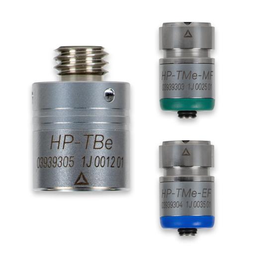

The HP-TMe Probe is a compact 5-way touch trigger probe in two-piece design. The HP-TMe Probe Kit 6 includes 1 probe body, 1 medium and 1 extended force probe module.
The HP-TMe is a compact 5-way touch trigger probe, the two-piece design is comprised of the probe body and a detachable probe module. The body and module are connected together by a highly repeatable kinematic magnetic coupling. The modules can be quickly changed either manually or automatically without the need to recalibrate the probe.
The probe modules are available in four versions each giving a different trigger force. The HP-TMe system can be easily retrofitted and is compatible with existing touch trigger controllers, extensions and accessories.
Kit Contents
1 x HP-TBe Probe Body (03939305)
1 x HP-TMe-MF Probe Module (03939303)
1 x HP-TMe-EF Probe Module (03939304)
