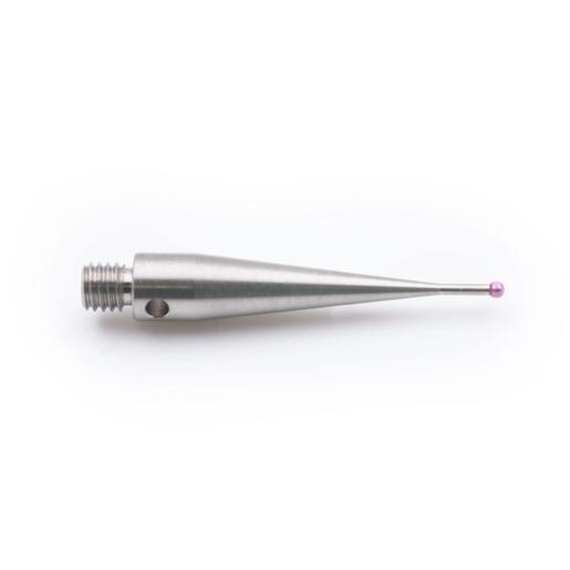

Straight stylus with M3 thread, ruby ball Ø 1 mm, stainless steel stem Ø 0.7 mm, length 21 mm. For use on coordinate measuring machines (CMM).
The stylus is an essential component of the measuring system, as it comes into direct contact with the workpiece during measurement. Straight styli are the most commonly used type in coordinate metrology. Different tip and stem materials are available to meet specific application requirements.
Ruby is the most commonly used material for stylus balls due to its exceptional hardness, high wear resistance and cost-effectiveness, making it the ideal choice for most measurement applications. An exception is the scanning of aluminium components, as aluminium can build up on the surface of the ruby ball. For these applications, we recommend silicon nitride stylus balls.
Stainless steel stems offer high stiffness and are ideal for applications where weight is not a critical factor.

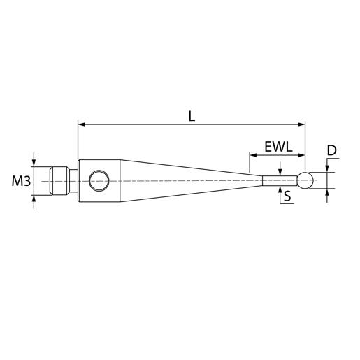

Part Number 03969301
Device CMM
Thread M3
Tip Material Ruby
Tip Diameter (D) 1 mm
Comparable to Renishaw Part No. A-5000-3551
Ball Grade G5
Length (L) 21 mm
Eff. Working Length (EWL) 4 mm
Stem Material Stainless Steel
Stem Diameter (S) 0.7 mm
Weight 1 g
