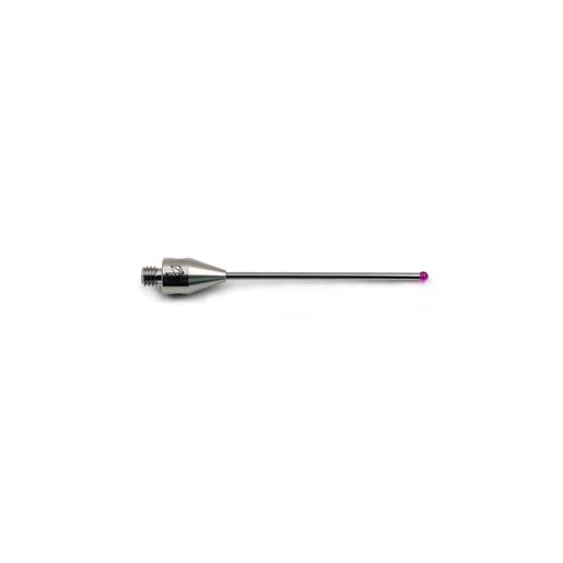

Straight stylus with M4 thread, ruby ball Ø2 mm, tungsten carbide stem Ø1.5 mm, length 50 mm. For use on machine tools.
The stylus is an important part of the measuring system. During the measurement, the stylus is in direct contact with the part.
Straight styli are the most common type used in the metrology industry. Depending on the application, different materials for stems and tips are available.
Ruby is the most widely-used material for styli tips. Thanks to its inexpensive price and high quality, it is the standard choice for most applications. It is an extremely hard material, which tends, however, to cause material build-up when combined with certain materials such as aluminium.
A tungsten carbide stem has high stiffness and less thermal expansion, compared to stainless steel.
Part Number H00046671

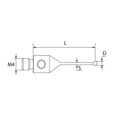

Thread M4
Device Machine Tool
Tip Material Ruby
Tip Diameter (D) 2 mm
Length (L) 50 mm
Stem Material Tungsten Carbide
Stem Diameter (S) 1.5 mm
