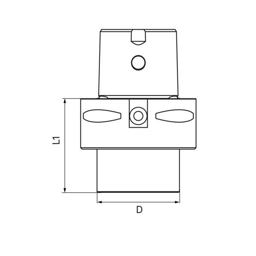

Polygonal hollow taper shank in accordance with ISO 26623-1 for use with Hexagon touch probes with D28 connection. For probe activation in machine tools with programmable through-spindle coolant or switchable air blast > 3.5 bar.
Hexagon original accessories for measuring systems in the machine tool ensure maximum precision and reliability in production. The shank establishes a secure connection between the touch probe and the spindle in the machine tool. Hexagon offers a wide range of shanks for various interfaces and different probe activation methods.

Part Number D28-C8-W
Product Type Polygon Tool Holder
Interface D28
Activation Method Water-switch (W)
Shank Standard ISO 26623-1
Diameter (D) 57 mm
Length (L1) 65 mm
Material Stainless Steel
Touch Probe Compatibility IRP25.10
