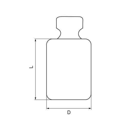

Extension made of stainless steel (Ø50 mm). For mounting between the Hexagon touch probe and the shank, to extend the length. Length: 100 mm / 3.94"
Added to your shopping cart.
Hexagon original accessories for measurement systems on machine tools ensure highest precision and reliability in the production. Probe extension made of stainless steel, is used to extend the length of the touch probe. It is mounted between touch probe and shank.
Length: 100 mm / 3.94 ", Ø50 mm.

| Material | Stainless Steel |
| Part Number | 91.00-V100 |
| Length (L) | 100 mm |
| Diameter (D) | 50 mm |
| Interface | D28 |
| Tightening torque max. | 120 Nm |
