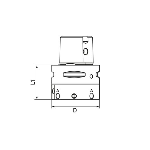

Polygonal hollow taper shank in accordance with ISO 26623-1 for use with Hexagon touch probes with D20 connection and bidirectional probe activation in the machine tool.
Added to your shopping cart.
Hexagon original accessories for measuring systems in the machine tool ensure maximum precision and reliability in production. The shank establishes a secure connection between the touch probe and the spindle in the machine tool. Hexagon offers a wide range of shanks for various interfaces and different probe activation methods.
Interface
- D20
Shank Activation Method
- Bidirectional: The touch probe is directly activated via a signal sent from the receiver.
- Bidirectional: IRP40.01, IRP40.02, IRP40.40-LF, IRP40.42, RWP38.41, TP-R-400
| Part Number | D20-C5-B |
| Product Type | Polygon Tool Holder |
| Interface | D20 |
| Activation Method | Bidirectional (B) |
| Shank Standard | ISO 26623-1 |
| Diameter (D) | 50 mm |
| Length (L1) | 36 mm |
| Material | Stainless Steel |
| Touch Probe Compatibility |
IRP40.01 IRP40.02 IRP40.40 IRP40.42 RWP38.41 TP-R-400 |
