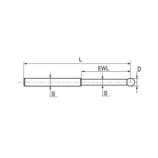

Straight stylus with Ø2 mm, ruby ball Ø1.5 mm, stepped tungsten carbide stem Ø1.2/2 mm, length 22 mm. For use on coordinate measuring machines (CMM).

Related Device | CMM |
Thread | D2 |
Tip Material | Ruby |
Tip Diameter (D) | 1.5 mm |
Ball Grade | G5 |
Length (L) | 22 mm |
Eff. Working Length (EWL) | 9.6 mm |
Stem Material | Tungsten Carbide |
Stem Diameter (S) | 1.2 / 2.0 mm |
Weight | 0.8 g |
