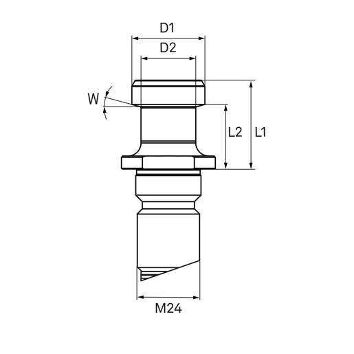

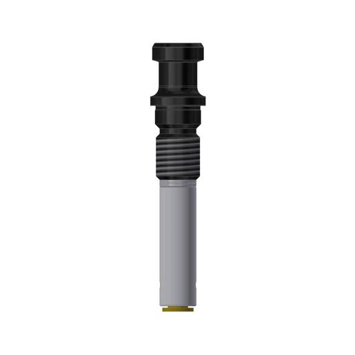

Pull stud with integrated mechanism for activating Hexagon touch probes equipped with taper shanks BT50, CAT50, SK50, SK50 DIN2080.
Dodano do Twojego koszyka.
Hexagon original accessories for measuring systems on machine tools ensure maximum precision and reliability in production. The tool holder is pulled from spindle’s clamping gripper into the spindle using the pull stud. This pull stud has an integrated activation mechanism and is used on Hexagon touch probes which are using the reliable pull stud activation method.
Shank Compatibility
- Taper Shanks BT50, CAT50, SK50, SK50 DIN2080
The images are for illustration purposes and the actual product may differ.
| Typ produktu | Kołek ściągający z wbudowanym mechanizmem aktywacji |
| Numer części | AZ-03 |
| Gwint | M24 |
| Średnica łba D1 | 28 mm |
| Średnica łba D2 | 21 mm |
| Długość (L1) | 34 mm |
| Długość (L2) | 25 mm |
| Kąt W | 15 ° |
| Norma | DIN 69872-28 |
| Maks. moment dokręcania | 150 Nm |
| Materiał | Stal Nierdzewna |
