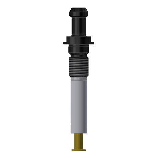

Pull stud with integrated mechanism for activating Hexagon touch probes equipped with taper shanks BT50, CAT50, SK50, SK50 DIN2080.
Hexagon original accessories for measuring systems on machine tools ensure maximum precision and reliability in production. The tool holder is pulled from spindle’s clamping gripper into the spindle using the pull stud. This pull stud has an integrated activation mechanism and is used on Hexagon touch probes which are using the reliable pull stud activation method.

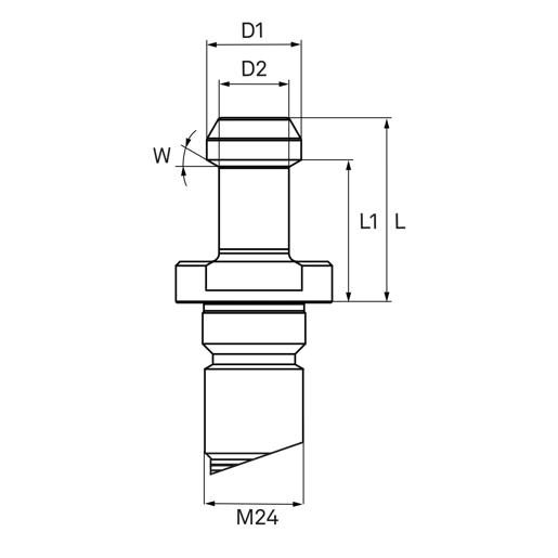

| Tipo de producto | Perno de tracción con mecanismo de activación integrado |
| Referencia | AZ-14 |
| Rosca | M24 |
| Diámetro del cabezal D1 | 23 mm |
| Diámetro del cabezal D2 | 17 mm |
| Longitud (L1) | 45 mm |
| Longitud (L2) | 35 mm |
| Ángulo W | 30 ° |
| Estándar | JIS B 6339 Typ 2 |
| Par de apriete máx. | 150 Nm |
| Material | Acero inoxidable |
