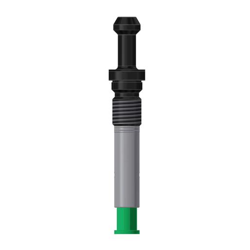

Pull stud with integrated mechanism for activating Hexagon touch probes equipped with BT40 taper shank.
Added to your shopping cart.
Hexagon original accessories for measuring systems on machine tools ensure maximum precision and reliability in production. The tool holder is pulled from spindle’s clamping gripper into the spindle using the pull stud. This pull stud has an integrated activation mechanism and is used on Hexagon touch probes which are using the reliable pull stud activation method.

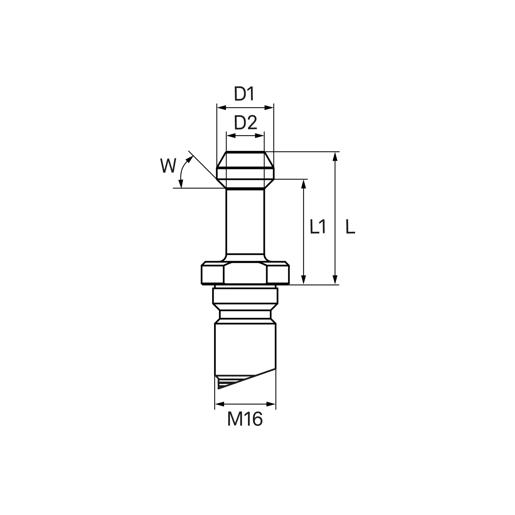

| Product Type | Pullstud with integrated activation mechanic |
| Part Number | AZ-06 |
| Thread | M16 |
| Head Diameter D1 | 15 mm |
| Head Diameter D2 | 10 mm |
| Length (L1) | 35 mm |
| Length (L2) | 28 mm |
| Angle W | 45 ° |
| Standard | JIS B 6339 Typ 1 |
| Tightening torque max. | 50 Nm |
| Material | Stainless Steel |
| Shank Compatibility | D28-BT40-A/B |
